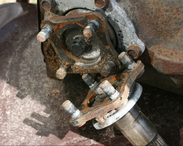

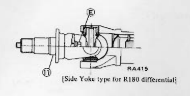

Good luck. The 240Z R180 pictures in the FSM's show the flanged axle. Looks like Nissan was shifting to the complete one piece halfshaft, similar to the ZX CV halfshafts, for the 280Z's. Learned something new.
I think that you just need a set of these. But the R180's confuse me because I've never had one. http://www.ebay.com/itm/Datsun-nissan-R180-axle-axles-yokes-240z-260z-280z-280zx-1970-1971-1972-1973-/252315140130?hash=item3abf278022:g:16IAAOSwoudW4Okt&vxp=mtr
I think that you just need R180 bolt-in axle flanges, instead of bolt-in half-shafts. I don't really understand which cars have which. Your thread title is misleading, your problem has nothing to do with "automatic" besides the fact that they came with R180's. jmortensen's thread shows what you want yours to end up looking like. Clip in versus bolt-in. Don't know how to get there. He seems to imply that the older R180's used the bolt-in flanged axle. So maybe you just need to find an older R180 and take the bolt-in flanged stub axles. http://forums.hybridz.org/topic/49194-differential-cv-lsd-hp-torque-r160-r180-r200-r230-diff-mount/ John Coffey's work implies that the early R180's had the flange you want also. I think that you just need an old R180. http://forums.hybridz.org/index.php/topic/78123-subaru-wrx-sti-r180-side-axles

You might give your u-joints a good look. It's hard to tell that they're loose without really prying on them. Stick a screwdriver between the yokes and reef on it with a bright light to see movement. Why do you think that your R180 halfshafts look different from the ones in the FSM? You can see the bolt head. Maybe you've been looking at the Subaru R180 pictures.
