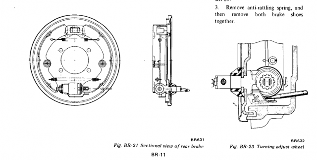

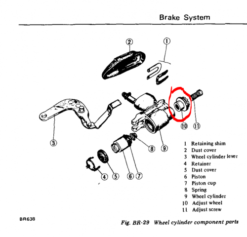

Passenger rear brake seized (1976 280z)
NewZed replied to nacitar's topic in Brakes, Wheels, Suspension and Chassis
Actually that last instruction isn't much good of the drum doesn't turn. Peel the rubber boot off the backing plate. -
Ya gotta turn this wheel to loosen the shoes and hope they haven't rusted/bonded to the drums. Page 12 and 13 - http://www.nicoclub.com/FSM/280z/1976/BR.pdf -
