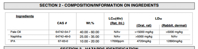

Seafoam is a can full of HC, with a little bit of rubbing alcohol added. And a ton of sales pitch, all in a neat looking can. You're in the common bind of trying to find a quick fix and ending up worse off with no easy way to get back to where you started, Keep track of where things started and what works. The details are important. Does "did that" mean putting the AFM back where it started or turning out the idle air screw, or both? Did you turn the screw out 1/2 turn or 5 turns? The EFI system requires some rigor and patience to get right but many people get it done.
