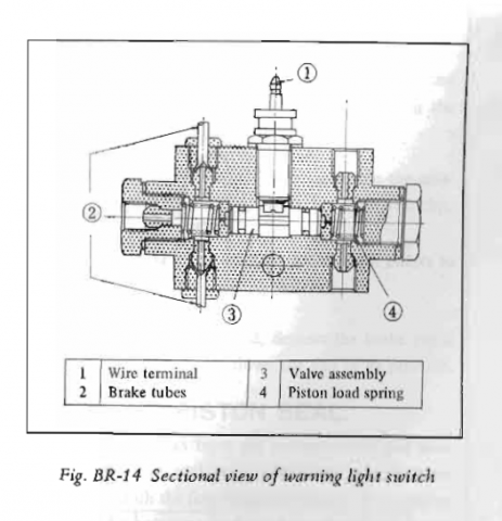

Here's a picture of the older switch. I really don't know how the older ones work, I've just seen that they need to be reset if they get tripped. Maybe they have a tendency to get stuck? My 76 had the switch and it fixed itself as soon as I fixed the problem (calipers on wrong sides). The OP never said what year car he's working with. -

Nissan changed the switch design sometime in the first few years of the 240Z. You're showing the newer design. -

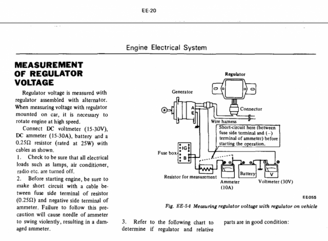

Missed the part about "you were tempted". Thought you already did it. There's a whole long procedure for testing the external regulator in the Engine Electrical chapter. But, it sounds like your L wire has just lost it's connection. I think that is described in FSM also. The simplest of checks is to just turn on the key and check for battery voltage at the T plug on the alternator. When working on electrical stuff, your first action is always to check that power is getting to where it's supposed to be getting. Once you actually use a meter for more than 5 minutes and either confirm power, or confirm no power, you'll never post again about "maybe I should check for power". It will be incomprehensible to not use the meter first. Some people carry meters in their car.
