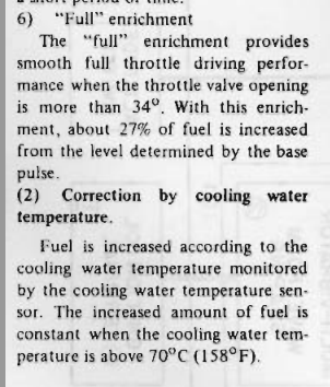

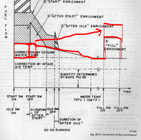

I read the diagram and explanation as 27% of the base pulse is added on top of the other correction factors. So by getting coolant correction back in to the equation, you lose fuel enrichment as the engine warms up compared to no coolant correction. If the diagram is approximately to scale, that's a lot of fuel.
If the CTS was disconnected it was richer everywhere. Now it is leaner everywhere. That's just how the system works. Your nose may not know but it's happening. Unless you tweaked the AFM back and are working off AFR gauge numbers. It's a crude system you've got there, good luck with it.
