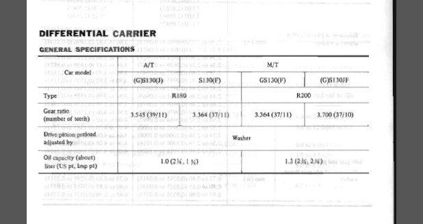

  24. I've not confirmed it but the FSM implies that some 1979 ZX models had the 3.36 R200 also. Edit - got curious and looked in the 74 FSM and the 3.36 seems to be the R180.
