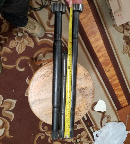

zboi Posted January 19, 2019 Share Posted January 19, 2019 On 1/15/2019 at 7:54 AM, Invincibleextremes said: The super 8.8 bolts in just fine. Measuring the axles and will be getting them cut and splined. Expand What axles are you cutting? I thought the stock mustang ones were hollow. Quote Link to comment Share on other sites More sharing options...
Invincibleextremes Posted January 19, 2019 Author Share Posted January 19, 2019 On 1/19/2019 at 1:20 AM, zboi said: What axles are you cutting? I thought the stock mustang ones were hollow. Expand They are, but they're not driveshaft style hollow. Theres no reason to not cut them. Btw, the right side is solid and the left is hollow. You'll need two lefts and a right to make a set for the 240z. The solid side axle tapers down and can't be cut and splined so i used it as a jig to measure the length needed. Quote Link to comment Share on other sites More sharing options...

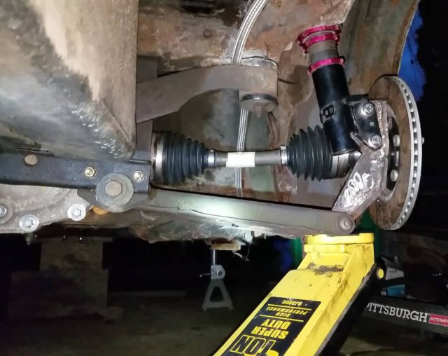

Invincibleextremes Posted January 19, 2019 Author Share Posted January 19, 2019 Measured angles and margin of error etc. So its dead center of its adjustment with this measurement. Allowing some room for adjustments on control arms and some room for suspension articulation without coming anywhere near its limits. Quote Link to comment Share on other sites More sharing options...
yellowoctupus Posted January 19, 2019 Share Posted January 19, 2019 Quote Theres no reason to not cut them. Expand The validity of that statement depends largely upon the hardening done to the original shaft. I would imagine they are induction case hardened at the splines only, so while it will be easier to cut down and remachine new grooves outside of the hardened shaft area, you consequently would have weaker splines. Additionally, are you having the splines rolled or cut? Quote Btw, the right side is solid and the left is hollow. Expand IIRC Ford used to run different diameter shafts to help counter wheel hop. (Of couse this does nothing for shaft strength, it just changes their torsional stiffness.) Quote Link to comment Share on other sites More sharing options...
Invincibleextremes Posted January 19, 2019 Author Share Posted January 19, 2019 Cutting hollow axles isn't my first choice, but they're still head and shoulders better than what came in these cars. Ideally i would ship out some solid shafts taken from a junkyard for cheap And pay for the service of 4 ends to be splined... This would still be incredibly cheap but give me some peace of mind. The core axles themselves are 55 to 75 bucks per side. The end plan is to just shell out the $1,200 for some 800hp axles plus 100 for them to be in a custom length. This is still cheaper and stronger than anything offered before in a 240z. But right now what ill be testing is just how much abuse the least favored setup will take before i have to either get the shafts replaced with solid cores or buy custom made shafts. On monday I'll get all that figured out. Quote Link to comment Share on other sites More sharing options...
jpndave Posted January 19, 2019 Share Posted January 19, 2019 (edited) @yellowoctupus is correct if they are case hardened. You'll need to determine that before re-cutting shafts. All of those half shafts are very poor designs for strength, lots of stress risers and improper sizing (thought the solid shaft has some elements of sound design which is why you can't respline them). They should look more like these for maximum strength. This design is not only substantially stronger and lighter but adds a "cushion" to the axle as it will wind up like a torsion bar rather than breaking and absorb some shock loads. The smaller diameter may be contrary to common belief of bigger is better but is actually stronger by quite a bit when done right. The production shafts are a for the masses piece that the beancounters dictate design to a large degree. Engineers throw mass at problems because it cheaper than better materials/design. (Photo from http://www.westgarage.co.uk/forsale/kits/shafts.html, just the first image that popped up from a Google search, not suggesting using them at all) Check with Moser Engineering or RCV. I think Moser will be your best price, RCV best quality. I would start with 4340 and use 300M for best strength materials - both are through hardened for proper strength, the 300M quite a bit harder. I'll be using 300M as I just don't want to take any chances. Moser has another alloy they use that would be a great starting point. I wouldn't be surprised if you could get a set of shafts from Moser at about 1/3 of your $1200 price. They will also do resplining. I have used them for both services, and they do quality work at reasonable prices. There are others out there that will do it for you but those are the first that come to mind. You'll be way better off if you get away from the custom car places and into the race and especially desert race crowd for this stuff. The problem is getting from the Ford inner differential and outer hub splines to standard 930 or 934 CV joints. Once you do that the rest is easy. If you want to look at doing the inner and outers that way, @1969honda and I would be in for the inners for sure and possibly the outers if they are compatible with what we are doing. I'll help with the design if you want. Edited January 27, 2019 by jpndave Quote Link to comment Share on other sites More sharing options...
jpndave Posted January 19, 2019 Share Posted January 19, 2019 (edited) BTW, any re-spline work is most likely going to be cut, not rolled. Rolling basically forges the spline into the shaft but is for much larger scale production and would be near impossible on the hardened stock. Moser would likely not have the reduced diameter on the shafts but again, price will be great for a custom shaft. For maximum strength, you need to step away from a lot of the stock pieces and prices go up. That's where the 930/934 CV pieces with corresponding stubs to hub and differential come into play. This is what DSS is doing for their super axles for the Mustang. HTH, Dave Edited January 19, 2019 by jpndave Quote Link to comment Share on other sites More sharing options...
