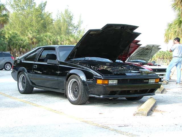

williamb82 Posted August 22, 2009 Share Posted August 22, 2009 well my car has flares stock. (wheels in pic are enkie 92 16x7 0 offset refinished by me) and yes this is MY car. looks like ill be going 17x8.5 +4 front and 17x9 -13 rear. the wheels i really want are hre 445r's, 18x8 front, 18x10 rear, 0 offset with matte charcoal centers and polished lip. expossed lugs and polished perimeter bolts. but at ~$4500/set without tires thats a LONG way off. Quote Link to comment Share on other sites More sharing options...
rudypoochris Posted August 23, 2009 Author Share Posted August 23, 2009 No one is going to doubt that is your car. In any case, larger flares are required then. An alternative to HRE's that can be more economical might be CCW's or Kodiak racing wheels. Good luck! Quote Link to comment Share on other sites More sharing options...
