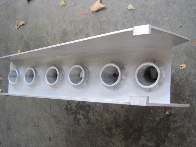

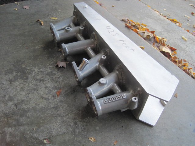

I have recently aquired a project off of flee bay from someone who was making their own turbo intake/plenum. It seems to be a good start to me and I would like to finsh and use it. INTAKE: As you can see from the pics the intake is a Cannon manifold which has been welded to the start of a plenum. The welding seems to be sound and air horns were incorporated into the entry of the runners. its seems to be nicely blended with a taper from 45mm to 37mm at the head side. I will have to decide where to install the injectors. I was supplied 14mm bungs with the manifold that are cut at 45 degrees. I'd like to place them close up against the intake flange so the bungs are drilled to enter the port as high as possible. This will be installed on a early e-88 head that's NOT notched for injection. PLENUM: the plan was to make a "shoe" shaped type plenum that is used on some RB manifolds. This design looks to be the easiest to finish from it's present state. The plenum area is 22"X 4.25". The tough fabbing will be incorporating the TB mounting to the plenum. On the other hand, the dual plenum idea is also being considered. This plenum is not so far along that I could change directions and go with a dual plenum like; http://www.racerxfabrication.com/page1/page5/page22/page22.html It's obvious from Monzter's work and others that this plenum has significant merits. I can purchase the larger plenum extrusion from Ross Machine(mailbox extrusuion). The cone extrusion is a little more difficult to aquire-unless Tony's idea of a Louisville Slugger will work, then it's a piece of cake. Find a bat that will blend in with a 60mm TB and connect to the mailbox! I know I am simplifying things here, but I think you see the direction. I'm posting up to get help from the members here. Please let me hear your input.

I put this thread in members projects because it will be a project that I hope I will get some help on from the knowledgable folks here on this site. As you can see from the pics this intake/plenum is far from done-but it is a nice start. I am currently running triple Mikuni's, but someday I was wanting to proceed on to FI and hopefully Turbo FI. I had some momentary thoughts of pressurizing my Mikuni's, but have decided-(by reading all the negatives) that it would be more of a cool factor than a good running set-up. I will post this disclaimer-I am a novice to FI and have a lot to learn. I have had plans, and still do, to run a megasquirt on my car. I was planning on learning about MS by installing it to run my spark on my current Mikuni set-up. Instead of doing a complete change over at once, I could get familiar with MS by running spark control and not take my car completely out of commission. I set-up my flywheel to run a Hall effect sensor and hopefully it will work. I will run COP. Not sure if this custom intake came from a member here or not, maybe they will chime in. It looks to be thought out by using the Cannon intake. The tig welding looks great and air horns are welded in on the plenum side to provide the proper radius. All that was blended in with some port work to make everything seamless. What you see is what I got, still have to close it in and set-up FI bungs and throttle body. I will be looking for input on injector placement and plenum shape. From what I have read it seems that injectors should be as close to head as possible for best idling and running characteristics-though it seems I have read that it's not critical to be right at the head. Agree? I am running an early e-88 head that is NOT notched for injectors. The bungs that were provided look to be for 14mm injectors. Still need to do research on what type,size injector to run. Love to run something common that I can steal from a wreck!! As far as plenum finishing, I will be taking into consideartion size and shape of the finished product. pretty sure that the TB will be 60mm. I haven't measured volume of this plenum yet, but sizing looks good. Trying to picture in my head what the original owner was going with the shape or location of entry. Please feel free to comment or give advice on this project. I am looking for some guidance and the proper do's and don'ts on this. I will be doing a lot of research on this and post my thoughts before proceeding.If anyone knows of similiar projects using the carby intake please send me a link.
