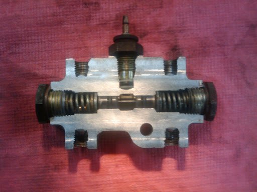

The FSM just says to replace the switch if it is defective. There is no latching device inside the switch, as in my 72 240Z switch , which would capture the piston and hold it. The springs at each end insure that the piston re-centers itself. I suppose that corrosion build up could cause the piston to freeze in the bore in which case the switch would be thrown away and replaced as per the FSM. Note if you take the switch apart and you tear a seal there are no new seals available from Nissan. You can bench test a switch by placing it in vise, attaching a volt meter to the electrical contact, and then push the piston in and out. The volt meter will turn on and off as the piston moves. Is the resetting of the pressure differential switch a Z car myth? Ancient Alien theorists would say yes. As per the guy with the boner hair on the History Channel. -

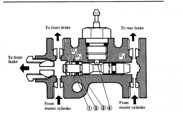

Newzed My 72 240Z had the switch like the second picture (picture from FSM). Is the first picture the early or late model switch? With either switch the springs at each end recenter the piston. After reading many conflicting stories about the switch I removed mine and dissected it to see how it worked. Manually moving the piston against the spring and and then releasing it the piston returned to the center resting position. In the later Z cars (280ZX) the switch was replaced with level sensing master cylinder caps -

The most likely scenario is that you allowed fluid to drain out of the MC tank for the front brakes. This will introduce air into the front brake lines making it impossible to bleed the front calipers. You will have to bench bleed the MC if this happened. This would be a good time to just replace it. The other scenario is that the MC was failing before the brake job and now the front part of the MC has failed. It has happened to me when I replaced the 240SX calipers on my 240Z. When I road tested the car after the brake job the MC let go. It happens. Now the infamous brake switch. All it does when the pressure drops in the front or rear brake circuit is that a spring loaded shuttle moves to the low pressure side blocking fluid flow to the"leak" and turning a red light on in the speedometer. That is it. The shuttle is spring loaded at each end and is self centering once you let off the brake pedal. There is no mechanism inside the switch to lock it one way or the other. Study the picture below. It is just a hydraulically operated light switch that moves when there is a pressure difference between the front and rear brake circuits. Hence "differential pressure safety switch". I replaced mine with a three way brass line connector years ago because I don't need a light to tell me that my brakes are failing. Do not gut the switch either as you will then tie the front and rear brakes together. There are no repair parts because Nissan built it as an expendable item in case the switch failed. So you either have air in the front circuit and or the MC has failed. There is nothing wrong with the brake booster unless you took the MC out and dropped the reaction disk inside the booster. That has a whole different set of symptoms. My 72 240Z had the switch as in the second picture. The second picture is from the FSM. -

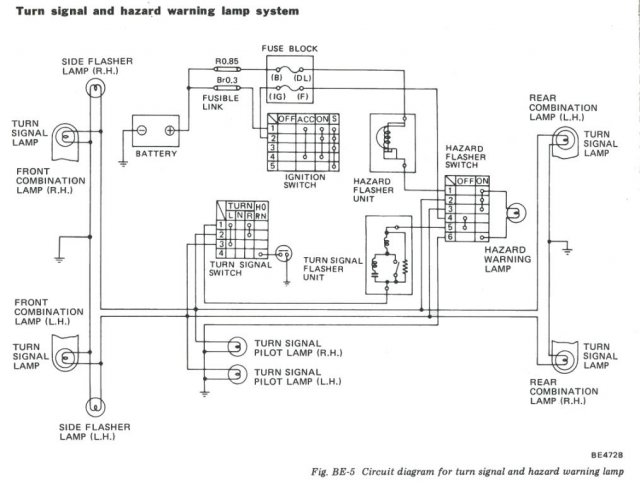

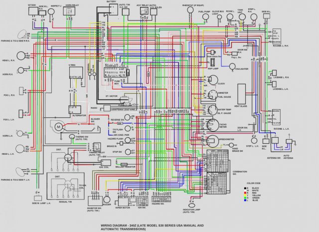

Do you have an electrical schematic? If not look around Hybridz or do a google search and download a pdf copy of the schematic. Some members here have colorized the schematic making it easier to read. With a pdf copy of the schematic you will be able to enlarge it making the switch connections easier to read. See attachments. BE Body Electrical.pdf
