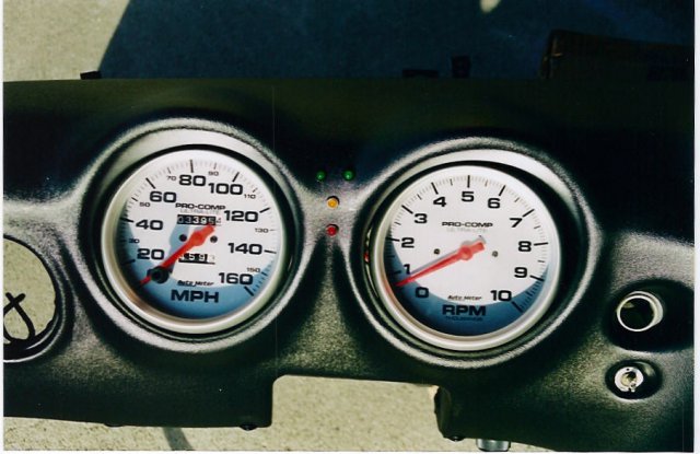

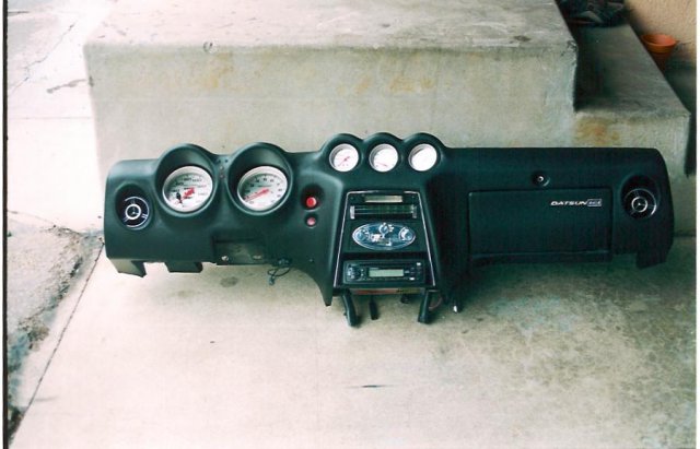

Here are 2 pictures of my full cap. to tell you the truth you realy can't tell it's a cap. For a perfect fit Follow the directions to the "'T". only apply the silicone on the perimitor of the dash. store the cap in a cool place, if you hold on to it for longer than a month. The dash cap shrunk a bit in the heat in the back of my pickup truck. Oh and one more thing ,I would suggest to remove the gauges ,heater/ radio pod and the windshield/ defroster vent cover so you can get the cap to fit snuggly on the dash. and a couple of well placed black screws to hold it in place while the silicone sets. I hope that helps.
