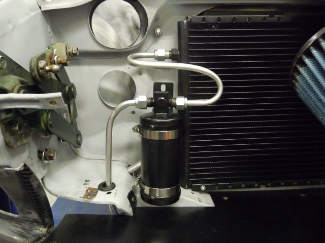

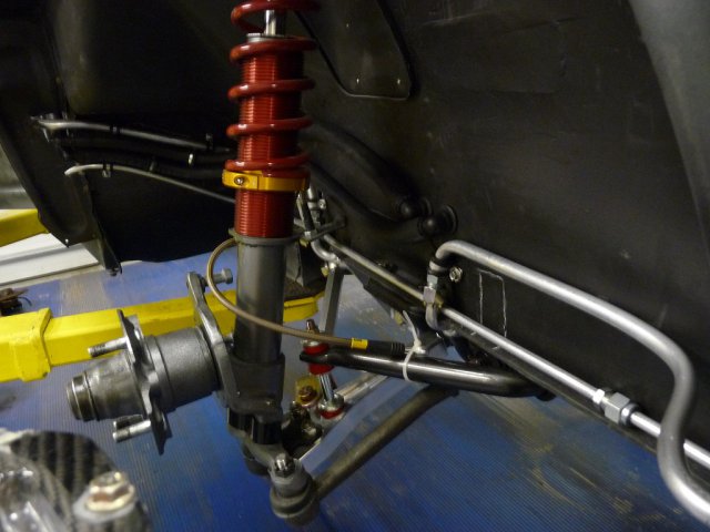

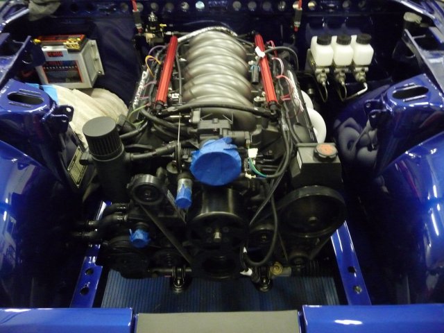

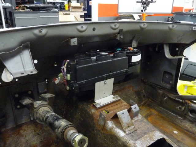

	I too am using the Vintage Air Mini II. It fits quite nicely behind the dash. On the motor end I used the OE LS1 compressor (F-body donor). To enable this I had to notch the frame rail and migrate from JCI mounts to Corvette C5 motor mounts (plus my own cross member creation). In order to meet my goal of an extremely clean engine bay all of the plumbing runs through the passenger side fender. Condenser and receiver dryer with trinary are all in front of the core support.

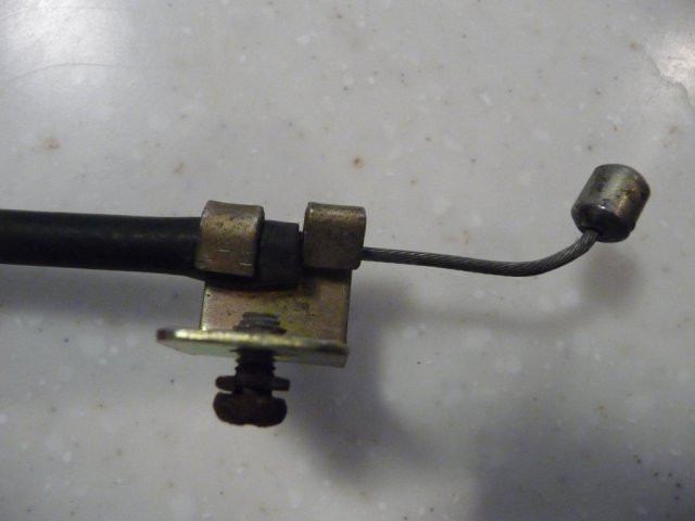

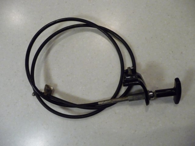

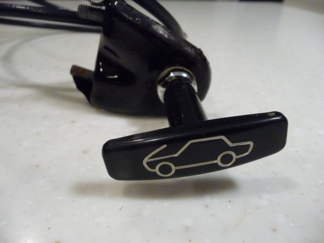

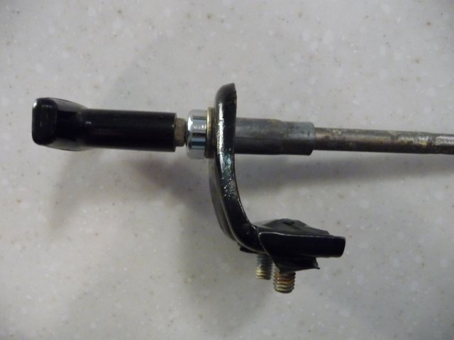

	I have the full cable assembly pulled from my '71. It is boxed and ready for delivery to your doorstep. $50.
