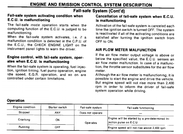

Cranks and goes to 3000 RPM for 2 sec then cuts off
NewZed replied to daves280z's topic in Trouble Shooting / General Engine
You could also turn up the idle speed, using the idle adjustment screw. That lets in metered air so the engine will stay running. Then spray carb cleaner at various potential leak spots. Your EGR work is a prime suspect also. -
That wire actually powers the solenoid in the BCDD. There's no sensor in there. Did you take the BCDD off or apart while you were cleaning the throttle body? Sounds like a vacuum leak of some kind. A leaky BCDD might be the problem. Crank means engine turning over, or crankshaft spinning. Crank is what the starter does, it used to be done by a human with a crank handle, that's why people still say crank. After cranking comes ignition, then starting, then running. -
