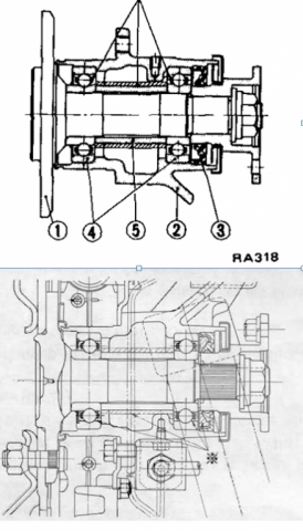

I posted your Facebook work in Post #4. It references 240 and 260, but no 280. Hence the darkness about 280Z's. It just seems odd that Nissan would add the R200 option to the S30 cars and create and leave in place a new problem. Since they changed other stuff at the same time, it's not clear if they missed something or not. Someday, I'll get a 240Z and do some measurements. Or check for binding when i have my 280Z apart again. It's working too well to take apart right now.

All I have are 280Z parts. So I went to the only other source available, the FSM, and compared engineering drawings. I don't have the software to manipulate these images the way I'd like but I think that I was able to match the bearing race sizes. And they seem to show that the 280Z flange and axle assembly is actually slightly narrower than the 240Z. It's not dramatic at all but might work out to a few millimeters in real size. I'm not trying to make a case for anything, just trying to figure out what's different. Feel free to take some shots. I used a caliper to compare images on the screen and resized them until the bearing races were the same diameter. 1976 drawing on top, 1972 240Z bottom. Note that you have to measure to compare flanges, the 240Z image is offset to the right.
That is my proposal. Assuming that track width and wheel offset are the same, that's all that's left. Or the 280Z's bind also, but nobody has noticed it.

I don't have the parts to confirm it but, assuming the wheel track widths are the same, 240Z and 280Z, the only thing left is the companion flange depth. The 240Z companion flange must stick inward farther than the 280Z flange.
