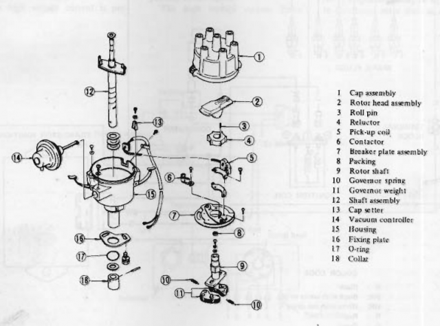

Pretty easy to pop the reluctor wheel off and remove the breaker plate. Then you can watch the weights and springs as you rotate the advance mechanism. Hold the bottom and twist the top. Something's not right in there. It should move smoothly, weights moving outward away from the shaft, and snap back to where the weights are in by the shaft. It does that over and over when in use, sometimes divots get worn in to the mechanism pieces. Things dry out over time also, along with rusting.
