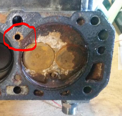

Can you add corrosion inhibitor? You can buy it separate from the glycols. Anyway, I'm way out here on the internet and I think I see signs. I'd pop the gasket off carefully and examine it closely, with a magnifying glass too, to be sure. Don't forget that a single overheat can warp the aluminum heads. You've had several with what might have been a bad water pump. Check the head for straightness. You might have had an initial overheat from a pump, then leakage due to head warpage. It's a downward spiral.
More likely a cracked head. Or a porting job has busted in to a water passage. These issues and pressure-testing to find them are described in the How to Modify..., and How to Rebuild, books. A picture of the head gasket would probably show more about whether or not it is the problem. The rusty water indicates that you ran without the corrosion inhibitors that come with coolant. That's not good.
