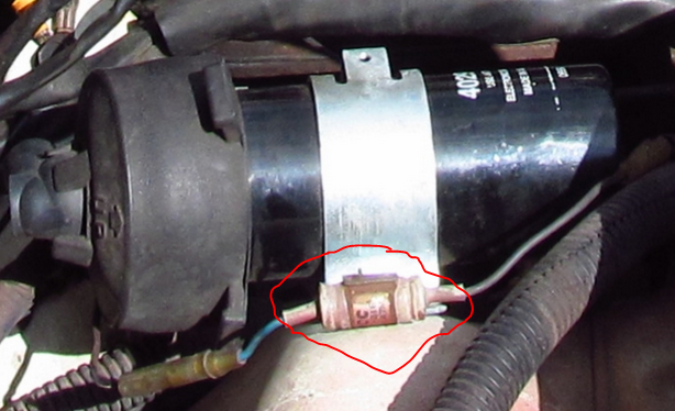

  11. If you mean the thing I circled in red, that's a capacitor, aka condenser. They do go bad occasionally. I see no ceramic pieces. The miss on the condenser makes one wonder what you meant by ignition control module. The coil looks stock. Might be worthwhile to browse through the FSM, Engine Electrical, and make sure you're getting the names right, at least. There are some parts on the ZX type distributors that can break after many miles.
