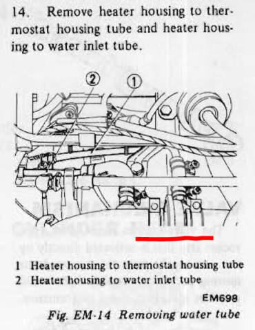

It's not really a bypass hose. Looks like somebody removed your air regulator and the heating plate that sits underneath it and just connected the tube ends. The AAR is shown on page EF-5, 7 and 17 and other places. The proper hose routing is shown on EM-4. Attached a picture. I can't remember if that coolant flow helps avoid water pump cavitation or not. There are discussions about it out there. Replacing the AAR and plate would be a good idea, it's a convenient mechanism. Could also be that everything's there but somebody couldn't get there fat fingers in to the tiny places to fix a leak so just bypassed it.. Anyway the coolant is supposed to flow underneath the AAR.
