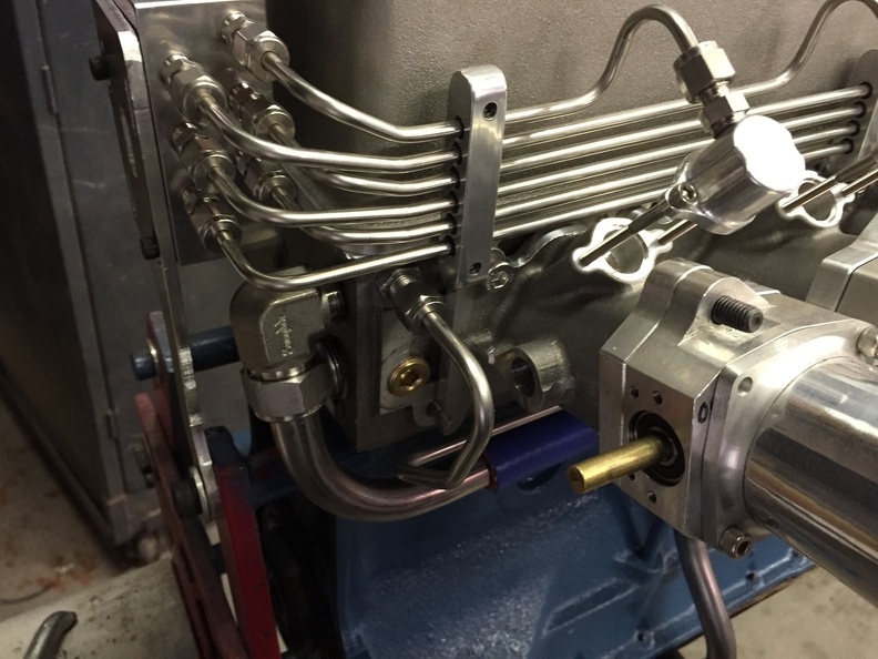

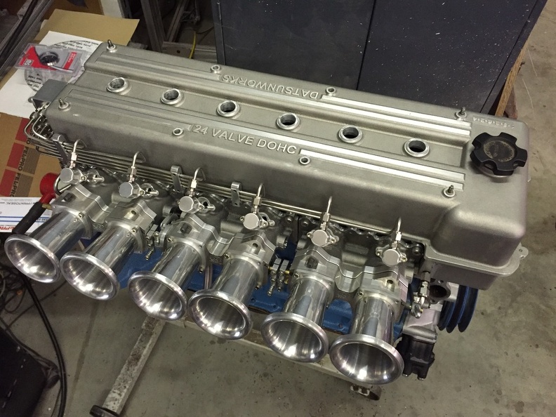

Valve cover done.

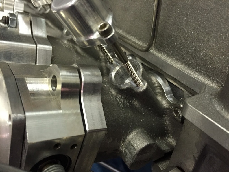

As I said earlier I'm having it powder coated but I wanted a couple of shots of it raw aluminum. I think it looks great but I want to see what it looks like coated. For me to leave it raw would require a bit of work and then back to the foundry for shot peening again.  Not in the cards. The flange is o-ringed. A little more work but since I'm sure to have the cover off and on a bunch it made the most sense.
Everything fits really well. Intake casting is a little scruffy but that's how it goes with prototypes.
I should have been a plumber:)
Should be ready to do oil pressure tests at the end of the week. I have a few more small items to work out but then I'm dead in the water without cams and a header.

The voice of reason in my head is wondering if knowing it works wouldn't be worthwhile before spending too much effort on appearance.
Only posting to support that tiny voice that you must be hearing in your own head...
The pretty stuff is cathartic for me and It helps me keep it moving forward. It's also when I'm looking for things I missed.  Plus if it doesn't work it will look great as a table!
Now climb back in your hole you heretic:)
... As a Journeyman Plumber for 35 years, I'll try not to take offense - that was pretty funny and a fairly accurate portrayal of how fitters see themselves. But Derek is apparently a God at fitting and plumbing already, so Plumber or Pipe Fitter makes no difference. That's beautiful piping work in any language.
