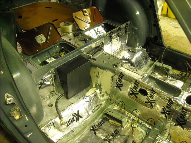

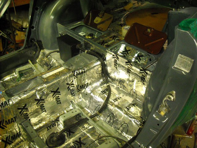

grannyknot Posted May 22, 2017 Share Posted May 22, 2017 You could also have a look at the X mat that Eastwood sells, http://www.eastwood.com/x-mat I just did my whole car with it and seems to be identical to Dyna mat but a lot less expensive. Quote Link to comment Share on other sites More sharing options...

grannyknot Posted June 24, 2017 Share Posted June 24, 2017 How heavy is the X-Mat? I'm hoping to not add too much weight. Each mat is about 3 lbs and I needed 17 mats to cover everything. Quote Link to comment Share on other sites More sharing options...
