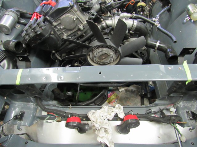

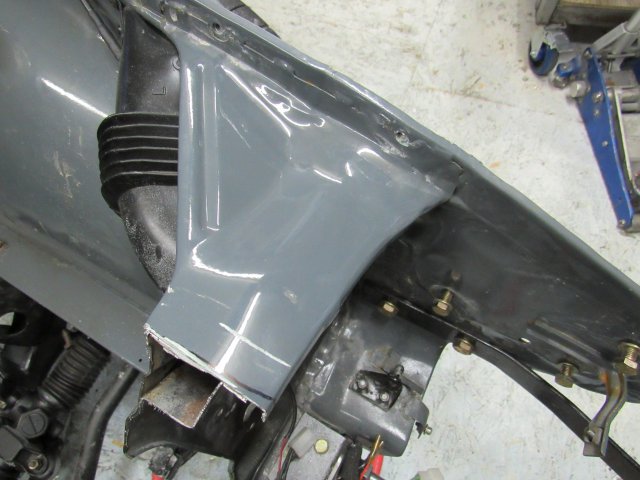

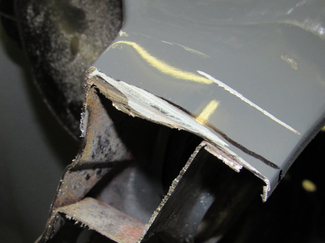

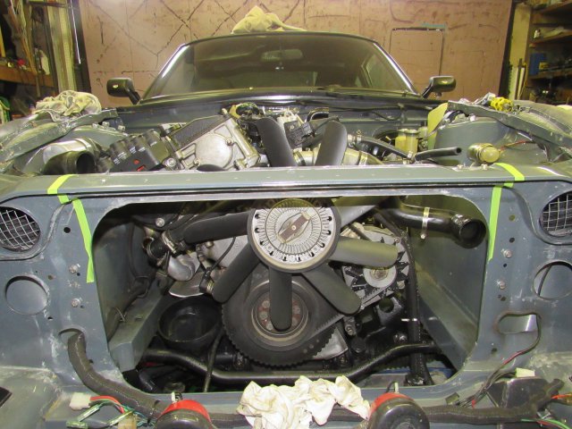

grannyknot Posted March 23, 2020 Author Share Posted March 23, 2020 On 10/29/2019 at 10:16 PM, grannyknot said: Thanks all, I'll post up some pics when I get it done but I think it will end up with something very similar to what @tim.d has done to his. Expand I got the cut out of the radiator support all finished so thought I would post some pics of the final product. Quote Link to comment Share on other sites More sharing options...
