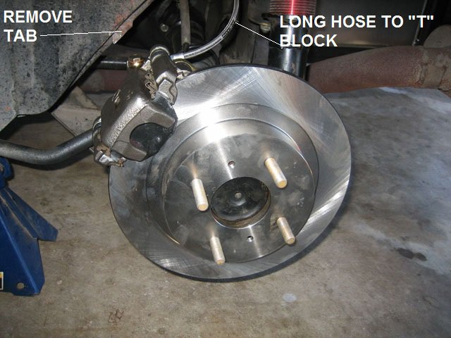

AXXIS/PBR ceramic brake pads: Toyota Front 45-01370U/4: http://www.importrp.com/product.php?productid=338850&cat=&page=1 240SX Rear 45- 02300U/4: http://www.importrp.com/product.php?productid=338820&cat=&page=1 Some parts stores may have them as well. The AXXIS pads are good street pads, but I am now going with more aggressive Carbotech AX6 brake pads : Toyota Front: CT137 AX6 PAD Material 240SX Rear: CT272 AX6 PAD Material I used generic A/N. SS brake hose to go from the hard line to the caliper. Each caliper has a A/N to M10 x 1.0 SS hose adapter threaded into the caliper. I did this so I could go to my local speed shop and purchase SS brake lines off the rack for future brake modifications. Just be sure to measure the length of each hose with the suspension at full droop and move the suspension to check for binding/rubbing of the brake lines. The 240Z brake fittings are M10 x 1.0. For the front do not use brake hoses with banjo connectors on the Toyota calipers. The Toyota S12 + 8 caliper is not machined or designed for banjo connectors and they will leak. You can use brake lines with banjo connectors on the 240SX calipers as they are designed and machined for banjo connectors. Use a fresh crush washer under the banjo fitting each time you remove the hose from the caliper. Parts stores have them. With the Modern Motor Sports kit, a longer driver's side brake hose was used from a hard line you supplied connected to the the T block and then the long hose to the caliper. The ready made hard line (parts store) was supplied by the customer from the T block was approx 20" (measure). See picture and links. I didn't like the long hose so I installed a new custom driver side hard line from the T block to the frame so a shorter 14" hose would drop down from the frame above the caliper to clear the axle and the tab. Don't cut/remove anything until you have worked out a plan that you know will work. http://www.typeischeap.com/pics/images/rearbrake.jpg http://www.zhome.com/ZCMnL/tech/Calipers/zbrakeupgrade.htm Do you have the parking brake cable brackets (hangers) for the 240SX calipers? You do not have to turn down the rotors. Use 84 300ZX non turbo rotors.

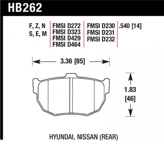

I have the S12 + 8 solid disk (front) and 240SX calipers (rear) with 1 in. Willwood MC and 280Z booster on my 240Z. I tried all of the popular performance street pads such as Porterfield and Hawk. Even though they are advertised for "street performance" they lacked cold bite which is what you want for a street car when some kid runs out in front of you. For the last two years I have used Axxis Ultimates front and back. They have better cold bite than the "performance street pads" and get better with repeated stops. As far as searching for pads I have found that searching by pad shape (every pad has an industry FMSI standard shape) works well: 89 240SX FMSI Shape Codes D230, D231, D272, D232, D464 79 TOYOTA 4X4 PICKUP FMSI Shape Code D137 http://www.nitomainc.com/npsp3.php?masterno=BP252

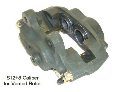

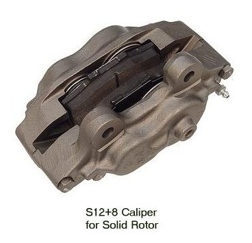

This can be a bit confusing. The Toyota S12 + 8 caliper came in two versions: solid and vented. See pictures. And then there is the S12W caliper that only came in the vented version. You can use either the S12 + 8 vented or the S12W calipers if you want vented brakes. The main difference is in the piston size. Both vented versions of the Toyota calipers require the use of a 84-85 300zx non-turbo rotor The non-vented S12 + 8 caliper will work with the solid stock 240Z rotor only. This may clear things up: http://driven-daily.com/build/s30-toyota-brake-upgrades Opinion: If your car is a daily driver, the Toyota solid rotor version is all you need and it is cheaper. The Vented swap requires a spacer to line up the caliper with the rotor. Also, the larger Toyota caliper may rub on your wheels which will require a spacer to move the wheel out. Don't forget that the Toyota calipers require a larger volume of fluid which means going to a larger 15/16" ZX master cylinder or a Wilwwood 1" master cylinder. Some people say that the stock MC is fine, but some don't like the long pedal travel.

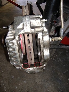

The door handle has a rod with a nylon adjustment nut. This adjustment can cause the door mechanism to unlatch the door if the nut is turned too far down the rod. You can test the adjustment by moving the door latch to the closed position and then pulling the door handle while watching for the latch to move. See pictures.
