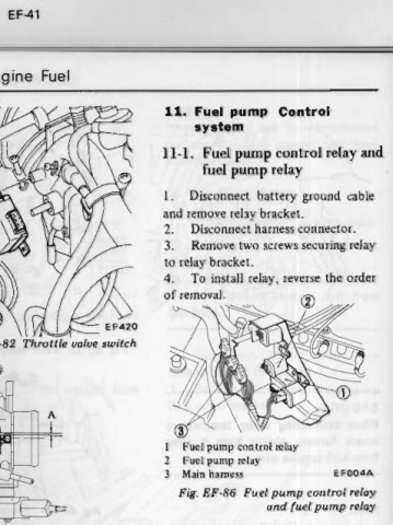

  2. Which relay did you use, 77 or 83? They're different. The test procedure for the relays is shown, with pictures, in the Engine Fuel chapter, or the EFEC chapter. Probably easiest to put a meter on the fuel pump leads and see if there's power when the key is turned to Start. You'll probably see power and can move on to some other possible source. Listen for pump noise. Disconnect the starter solenoid so it will be quiet.

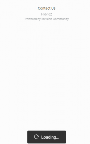

  15. If I click on any of the page buttons for the attached thread it locks up the page, doesn't load anything, just goes to a blank page and gets stuck with a "Loading" icon. Edit - also, it's not clear that the link is a link. It looks like just another image. I know that this software has a way to removed the image formatting and make it just a text hyperlink(?). They work for this Site Support thread though.

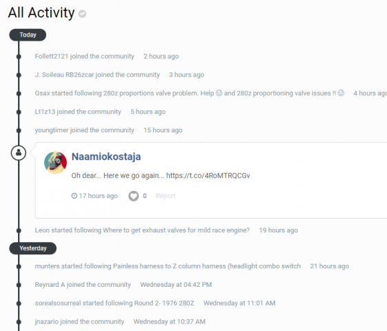

  23. Maybe you should make that the main screen people see when they get on the site. Is there nay way we can see that screen. just to monitor ourselves, for fun? The site looks like it's working but it's actually gone backward since the last time I was on. Some of the views don't work right, like the Activity screen. This is from 8:15 pm today. There's been a lot more activity than shown.
