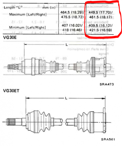

Here you can see that there's only 1.58" of travel combined in the two joints. Could be that your problem isn't too little travel, but too much, on the inner joint. 2 x "not much at all" = correct.
Your question has already been addressed then, you just need to use the answer in your response. Seems like you might be looking at your axle backwards. And 2 inches of travel in either direction would be 4 inches of total travel. I don't think that's possible.

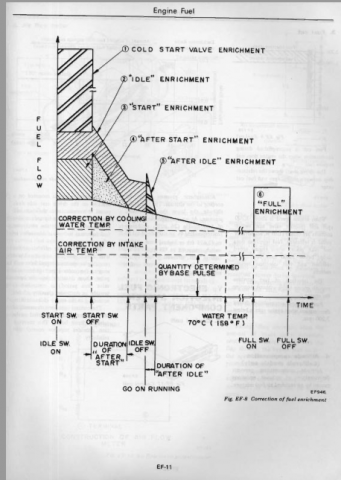

By "crank" signal, you mean Start, right? Pretty sure that is for Start enrichment and won't stop the engine from starting. He has the FMS and the EFI Guide to show this, and he's already run some tests. He just needs to keep track of what's happening, when it happens. Especially now that he knows it's a sporadic problem. The part about the trigger from the coil negative is right. But that's also covered in both of the books he's been using. -

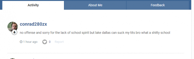

I'm sure it's an unintended consequence but the new software seems to be open for high school trolling. Is it Twitter? Not good. This is some weird BS... http://forums.hybridz.org/profile/55044-conrad280zx/
