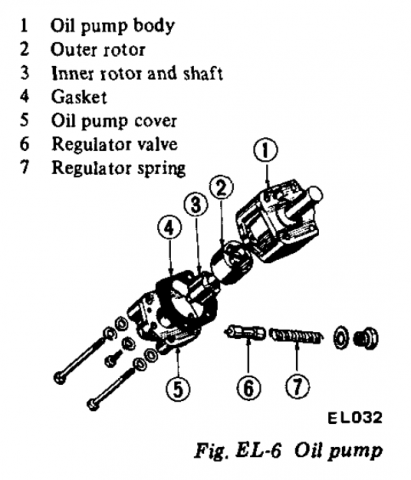

I think that I misread your post. I was thinking that you dropped the whole pump and the distributor shaft fell out. You should be able to just put the pump back together without worrying about orientation. Turn the rotor until is drops in to place. Still doesn't hurt to read the FSM to understand how things work.
Looks like you might be overthinking some things and underthinking others. Close the heater valve and run with it closed, and determine what happens. It's very important. It might not be the source of your problem but you need to know.
Follow the instructions in the Factory Service Manual. Engine Mechanical and Engine Lubrication chapters both have them.
