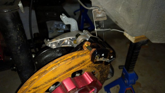

Yep...sure do...these are the calipers I use for the brackets in question. Wilwood MC4.
Cheers
Ended up drawing making my own since I have the CAD, 3D printer and CNC machine available. Im sharing this because I have tested these parking brake calipers and they do work good as a parking brake. Not made for anything else but just for parking.
I also made custom brackets for the Brembo’s too. Both are separate pieces just in case I want to swap one of them out for something else.
Edited by mainboyd
