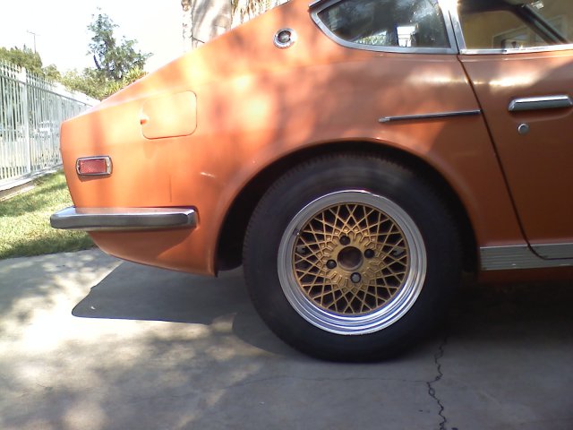

Kevlars30z Posted January 26, 2010 Share Posted January 26, 2010 These are my wheels. Dont know what kinda they are did some research and it seems that they are riken wheels but im gonna try to take of the tires to see if theres a stamp inside. Quote Link to comment Share on other sites More sharing options...
