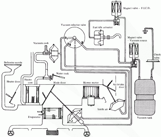

According to the image URL, this is a diagram of a 75 Image downloaded from http://www.atlanticz.ca/zclub/techtips/vacuumlines/ and rehosted here for longevity One solenoid controls AC fast idle (the plunger on your intake manifold, if you still have it), and the other seems to control on/off for the whole climate control system, I'm not sure what triggers that (maybe blower switch? I have to check a diagram) The vacuum heater valve everyone is referencing is the "Vacuum cock" on this diagram, which is basically there to make sure you don't run the heater and AC at the same time.
