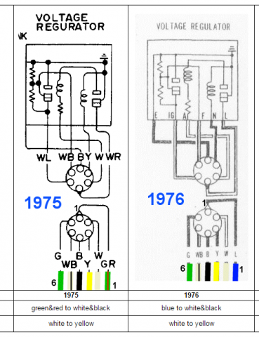

Since you did say earlier that you saw battery voltage at the bottom leg of the T plug and everything else looks good here's something that happened to me a few years ago - the T plug connector was loose and dirty. It wasn't making electrical contact. I found that I could wiggle it to a new spot and the alternator would start charging again. It was an odd thing. A quick squeeze with some needle-nose pliers fixed it. Make sure the T plug is making good contact with the alternator terminals.
And all of your measurements in Post #25 look correct. Your comment in #26 doesn't fit what you saw. Everything looks fine. BUT. You didn't show the measurements at the T plug.
It seems to me, based on the way you're writing, that you might not really understand how to measure voltage. No offense. But your word usage is not the way a person experienced in these things would write. Voltage is not gotten. It just exists across points in a potential circuit. " earth on the alternator is getting 12v from the positive on the battery". It looks like you put one probe on E and the other on the battery positive terminal and saw 12. That would be a correct reading for proper wiring.
Are you sure that there is continuity to the battery positive post from the alternator's charging wire, the BAT terminal? Follow the path. You can test if it's charging by measuring between the BAT terminal and ground, directly from the back of the alternator. You can test continuity by measuring battery voltage at the BAT terminal directly with the engine not running and key off. The BAT terminal is always connected to the battery positive post, normally. Did you check those fusible links yet? You might just stop, now that you've been working on this problem for a while, and think about how the system works, and what should be connected to what. Could be that you've been assuming that the charge wire is connected to the battery, but it's not.
Seems like the only information you might get would be if it's flat-tops or dished, or if it's a turbo block or not. But since it's a stroker, the crankshaft and pistons have been out so the first is irrelevant. The second might be knowable, but that number is lower than my 1976 number 71155 so, if it is an L28 it's probably a 75 or 76 N42 block. Nissan put the engine number on the ID plate by the strut tower, up to about 76-77.
We've overlooked one of the basics of most Z and ZX alternators, especially the parts store remans - they don't put out much current at low RPM. Did you rev the engine and check voltage? If you have battery voltage at the L terminal (the bottom of the T) the alternator should charge if it's spinning and nothing is drawing it down. Your battery is getting low, 12.4 means it at about 70% and needs a charge, and it might be drawing all of the current if you're doing your voltage checks at idle RPM. If you give it a rev and it still doesn't charge, have it checked at a parts store. Parts store remans aren't known for high quality, generally. Your wiring seems right. It should work.
That's the condenser. And the charging wire (withe with red stripe). The battery cable is the one that goes from the battery to the start lug. It's big and thick. Like a cable. Just connect it like it's shown in the picture. To the BAT terminal. The wire end of the condenser connects to positive, the body to Earth/ground. E. It is there to absorb electrical noise. Don't leave the blue wire coming out of the harness disconnected because it might short to ground. Hopefully it hasn't already. Check your fusible links while you're in the engine bay. To be sure you didn't short something and blow a link.
1975 doesn't show a blue wire but 1976 does. Use your meter to find the switched power wire. You might have 76 colors in your 75. Nissan changed things on the fly sometimes. And what does "battery connector for the alternator" mean? Doesn't paint a picture.
The wire connects to the thick charging wire. You should always check your work with a meter if you can. It will save you a lot of time. If you don't have battery voltage at the T plug with the key on, work back in the wiring until you find the problem. The 1975 wiring diagrams will help you also. The Engine Electrical chapter has small specific diagrams so you don't have to use the big one.
If L doesn't get power with the key on the alternator won't charge. Do you have a meter? Is your ammeter connected? Have you had the car long? Did the old external regulator system work? Why did you decide to do the swap? Is the alternator body grounded? The thing is called a condenser. The body is grounded and the wire is connected to the main charging wire.
