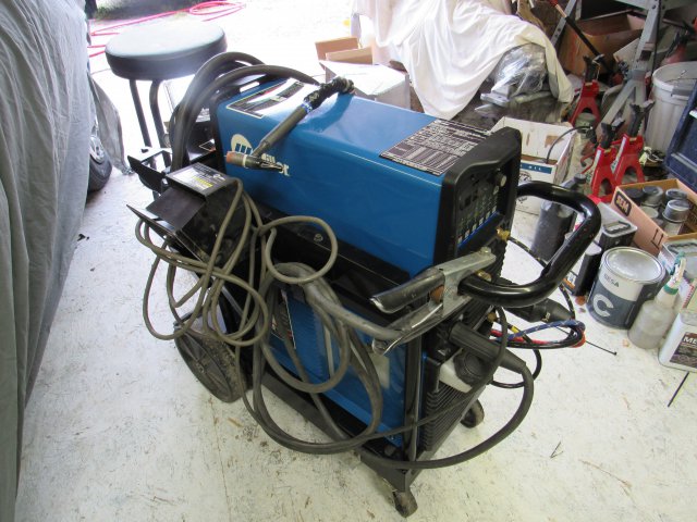

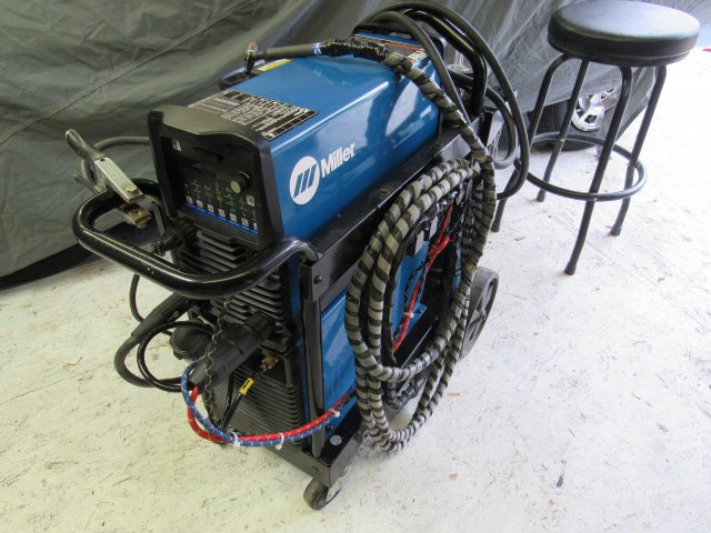

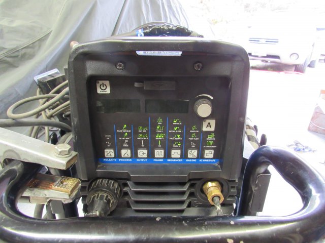

madkaw Posted October 16, 2017 Share Posted October 16, 2017 I bought a used MILLER Syncrowave 210. Its above your budget , but I found it used for almost half retail with only a few hours on it. I have little tig experience , but this machine makes it easy . With inverter science it makes it small and I can do 110 or 220. Spool gun works better than I could have expected . Makes the pain of selling my Mikunis for a welder easier to swallow Quote Link to comment Share on other sites More sharing options...
