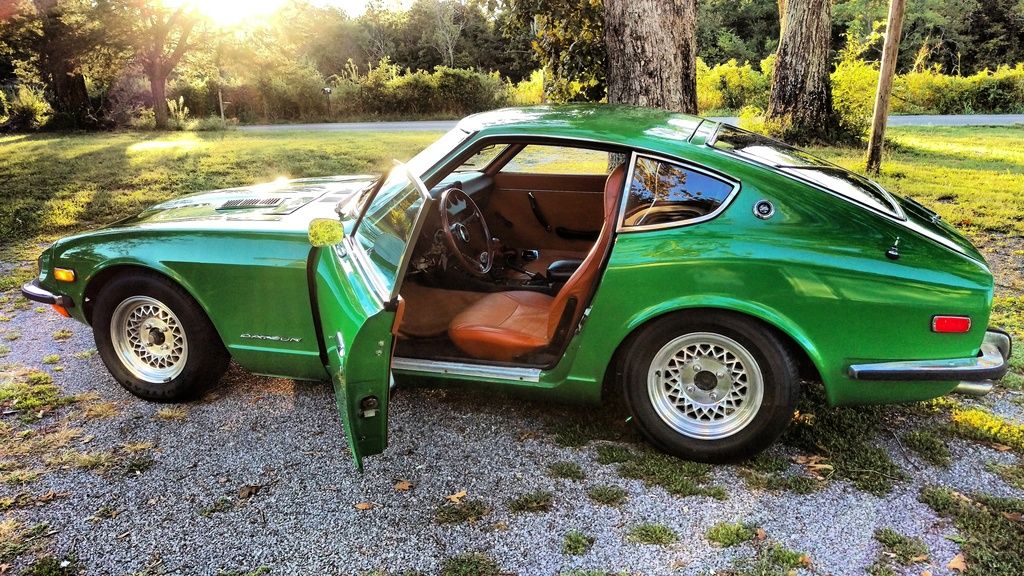

Here are mine. I like 17's cause I can still have a side wall on the tires. I had Honda wheels with adapters until I took a wheel off one time and found that I had broke a rear stud and didn't even know it, leaving me with 3 studs which made me feel very unsafe. So I spent the money on custom Boze wheels that are worth every penny. 17x7 and 17x8,225/45 and 235/45, 0-offset on both.

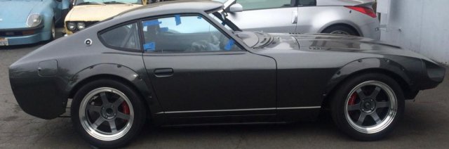

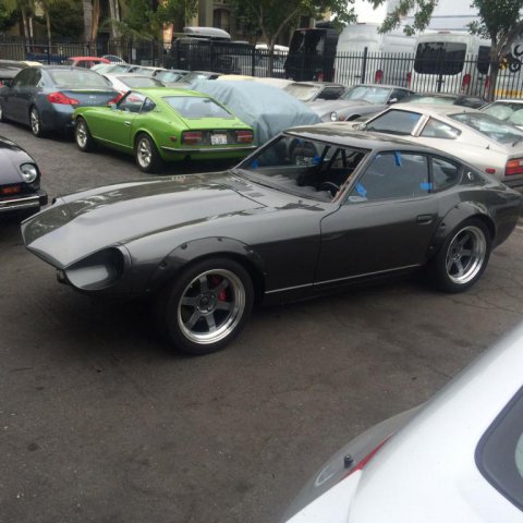

On a related note however, I will include a pic or two of  Gixxersquid's fantastic build and motivation for my wheel choice.

Any idea what wheel size and offset in these pictures?

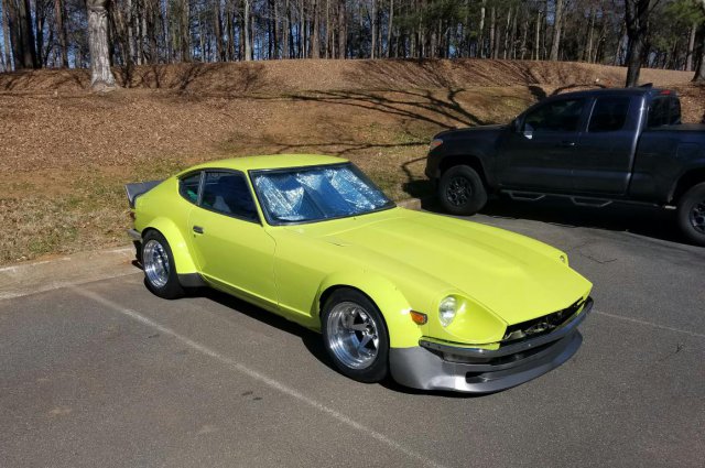

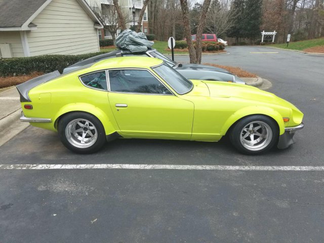

O geez, that looks awesome!  What are your tire types and sizes, and who did your wheels?
Wow! Who made your barrels?
Wheels were built by Pine Engineering out of NZ. With the exchange rate they were cheaper than you'd think (not $600 cheap but you get my point).
Tires I'm running 235/50/15 Toyo R888 fronts and 275/50/15 Nitto NT555R.

That looks great! What's your rim width and offset?
As per his post a few pages earlier (#2071), he is running a 275"-40 series tire on the rears which could be on either 10" or possibly 10.5" from the limited run 2015 Te37 V-SL as seen on post (#2067) same page supplied by member Docaam. The 2015 limited run V-SL line had a (9.5" -15), (10" - 20), and (10.5" - 25) options with more back spacing than the standard Te37 V like I bought. Attached is the 2015 limited run sizings as well as the 2016 which did not offer the wider options in 17".
I am curious to know exactly as well.
