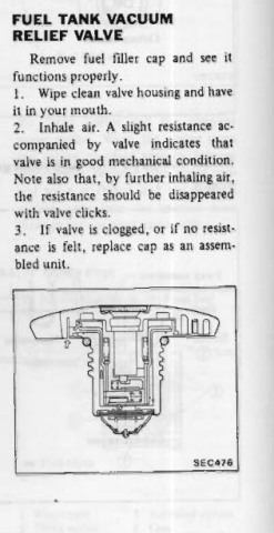

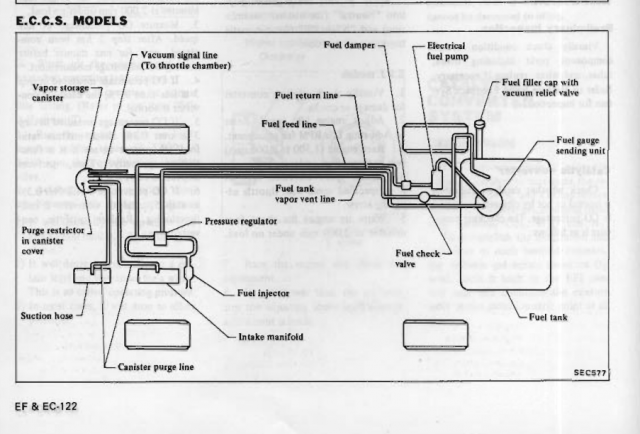

That's different than a 280Z's. But that's what "vacuum relief valve" means on the diagram I attached. If you have a mighty vac you could probably rig something up to see if the valve opens. Or if no one is looking you could suck on it, procedure described in the attached picture. By the way, all of these pictures come from the final few pages of the 1983 EFEC chapter.
If it's not just your imagination, it seems like tank venting might be involved. Not through the cap but through the charcoal canister and its vacuum lines and vent hoses. It may be that it's not lack of fuel but overpressure. Just a guess. Maybe you're boosting the fuel tank. The cap should have a little spring-loaded valve on the inside center. Take a look. You can pick it open with your fingernail. It lets air in but none out.

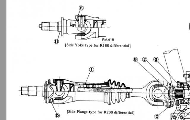

I would read jmortensen's diff thread in the FAQ section. You might have some changes from stock. A welded R200 might be going backward. Or maybe Nissan converted to clip-in axles with the 280Z R180's. Edit - actually that picture I posted is from the 77 FSM. So what you have doesn't match. http://forums.hybridz.org/topic/49194-differential-cv-lsd-hp-torque-r160-r180-r200-r230-diff-mount/
