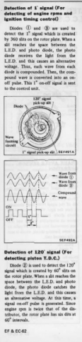

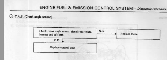

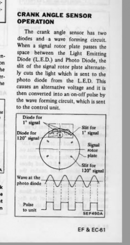

I can't really follow what your expectations are but the attached pictures might help show what the CAS output should be. Two of the wires should show a voltage pulse, from zero to probably ~5 volts. One of the wires will pulse rapidly as you turn the distributor because it's seeing 360 slits per revolution, the other will sit at zero, I believe, and only change state six times per revolution. So, if it were me, I might fabricate a narrow blade-shaped probe that I could slip in beside each wire in the connector while it's plugged in, to measure voltage. With the key on and no CAS movement, you'll probably get a 5 (that's your power supply to the CAS from the ECU), and maybe a 5, and a dead one. Stick the probe in the two that aren't constant 5, and spin. I might be way off, but that seems to what the pictures and text say. Added the "And so forth" picture just for the humor.
