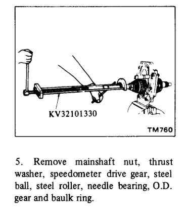

Looks like you have to disassemble the transmission to get the O.D. gear off the shaft. 1982 MT chapter.. And it's 80 - 83, not 79 - 83. 79 for sure and maybe early 80 are the "wide" ratio transmissions. -

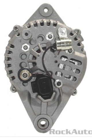

Looks a lot like a 300ZX alternator. 70 amps instead of 60. http://www.rockauto.com/en/catalog/nissan,1986,300zx,3.0l+v6,1209563,electrical,alternator+/+generator,2412 Take it to a parts store and make sure it's bad. Then see if it matches a 1986 300ZX. You might have to call ahead so that they can get one in for you to look at.- 6 replies

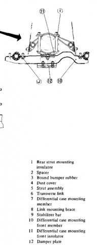

It's an anvil that Nissan provided with every car. It bolts to the bottom of the diff mount crossmember. Actually, it's a vibration damper. Many people remove them and never notice a difference. It is a handy weight and/or anvil to have in the shop though. Nissan doesn't mention it much in the FSM. I've only found one instance.- 2 replies
