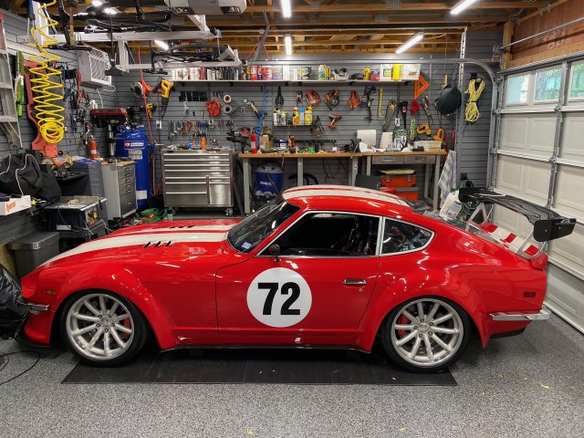

markrolston@mac.com 27 Posted September 29, 2019 Author Share Posted September 29, 2019 The car is essentially finished (lol, really when is it ever really finished?) and ready to race this fall and spring. I still haven't anodized the wing mounts. I'll find some time in the winter to do it. It's been 11 years building this (slowly) so it's time to drive it. I do plan on doing some photography and video asap to get ahead of eventual track wear and tear. Quote Link to post Share on other sites

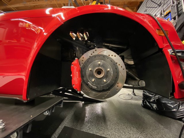

markrolston@mac.com 27 Posted September 29, 2019 Author Share Posted September 29, 2019 btw- useful info for some. we've been chasing down a soft pedal feel with the brakes. They work but given the disc size (14") they should work a lot better. It turns out these wilwood calipers actually flex under braking so they apparently give up some of the critical braking pressure. That is super lame for what should be solid equipment from them. I'm now looking for another caliper that fits and is built better. Quote Link to post Share on other sites
EF Ian 11 Posted September 30, 2019 Share Posted September 30, 2019 11 years, thats a long time, you definitely deserve to enjoy this epic Z you have built yourself. Some videos at some point would be great. Bad job on the wilwoods, my smaller setup works great but I did have an mind to upgrade to an AP Racing setup when I can. Quote Link to post Share on other sites
260DET 32 Posted October 4, 2019 Share Posted October 4, 2019 Willwoods do have a general reputation for flexing, are StopTech's any better? Quote Link to post Share on other sites
markrolston@mac.com 27 Posted March 9, 2020 Author Share Posted March 9, 2020 front Wilwoods have been replaced with Stoptechs. It feels better already. I'll find out for real at COTA next weekend. Working on a set of canards to try and balance front-to-back. Otherwise I think this thing is finally ready to go beat up on the track. Quote Link to post Share on other sites
EF Ian 11 Posted March 9, 2020 Share Posted March 9, 2020 Looks awesome and the stoptechs are really nice. Can't wait to see some videos of this thing. Quote Link to post Share on other sites
260DET 32 Posted March 13, 2020 Share Posted March 13, 2020 In car race video is badly needed, once sorted and they all have to be sorted, this masterpiece should be a great nicely balanced circuit car. Quote Link to post Share on other sites
