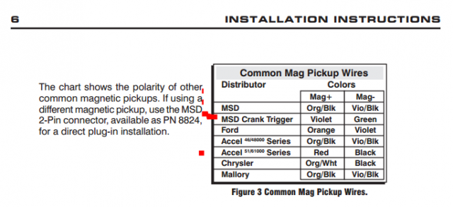

One thought that crosses my mind whenever I see these problems is to just run a separate coil and ignition module, with the coil just dumping to ground. Use the coil negative to run the EFI and tach, and let the MSD box do its thing on its own circuit. The 280Z VR signal should be strong enough to run two modules, I'd think. If you have a dual pickup distributor you could even use one pickup for the MSD and one for the EFI. That should definitely work, they wouldn't even see each other.
I think that I got my magnets mixed up. Apparently, the MSD magnetic trigger is not a variable reluctor setup, it's different, backward, with magnets moving past metal sensors instead of metal moving past a magnetic sensor. Designed to be used with an MSD trigger wheel. I'm not sure what the output looks like or how the MSD box uses it. My mistake. There seems to be a ton of confusion around the internet and even from MSD on which wires are triggering what. People seem to confuse triggering the MSD box to give spark, with triggering the ECU to cause injection, and also triggering the tachometer to move the gauge needle. Frankly, I don't know why people use the MSD boxes. Multi spark benefit only at low RPM, with a lot of problems and effort to get things working. Seems like there are better ways out there to get strong spark with or without the extra spark timing controls or rev-limiting. Sorry, and good luck.
